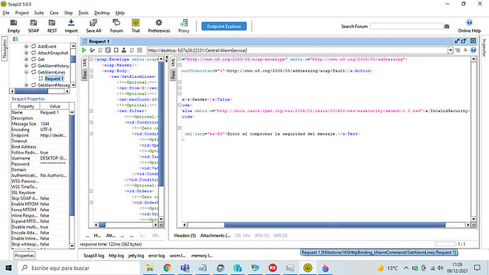

I got the next answer from SoapUI:
Have u passed token to api call u wanted to get result?
Here is example of getting token and then passing to method to get results.
Note: basic user has to be added to administrator group.
https://localhost/ManagementServer/ServerCommandService.svc
and in soap request

u will get token.
With token
http://localhost:22331/Central/AlarmServiceToken?singleWsdl
