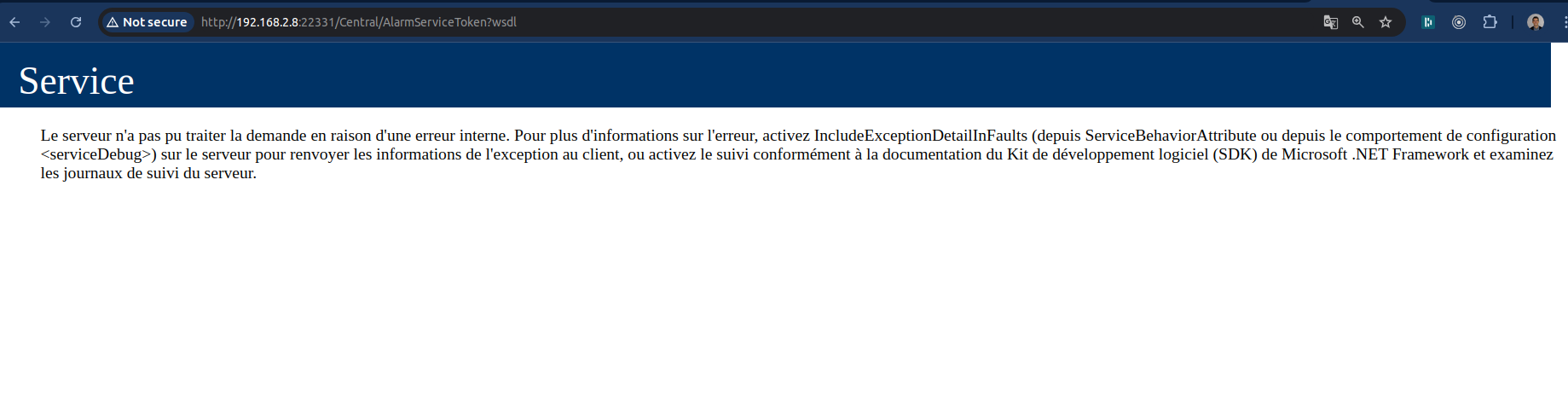

We have had some issues with the 2024 R1 version: the AlarmServiceToken, located on http://event-server:22331/Central/AlarmServiceToken?wsdl, raises an internal error. Simply trying to open the wsdl in a browser shows us the error. This happens even before authenticating or using any method in the API. Please find below a screenshot of the error (description in french though).

Hi Robin,
You are right that WSDL fetching is not working in 2024 R1. However, the SOAP API itself is fully functional. I would create an issue and fix it for 2024 R2 (WSDL fetching). But your problem should be somewhere else (If the whole API is not working).
