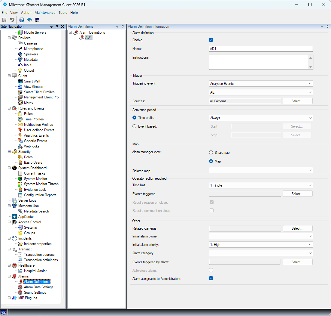

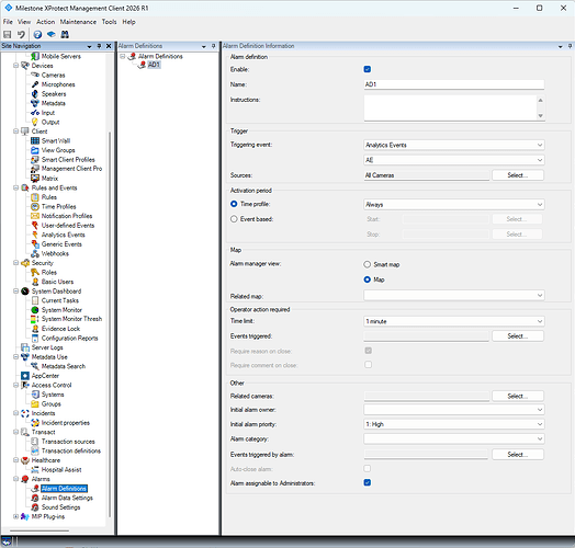

When you describe it my first suspicion is if you are missing a fitting Alarm Definition. Using SOAP you can send an Analytics Event or an Alarm. Using Rest you can only send the event. This means you must have an Alarm Definition that is triggered on the event and turns the event into an alarm that can be seen in the Alarm Manager in the Smart Client.
Alternatively if you go into setup mode in the Smart Client you can configure the Alarm List to list events instead of alarms, but I have a feeling that this is not what you want, you want alarms is my guess.

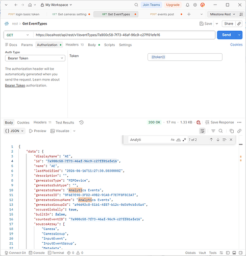

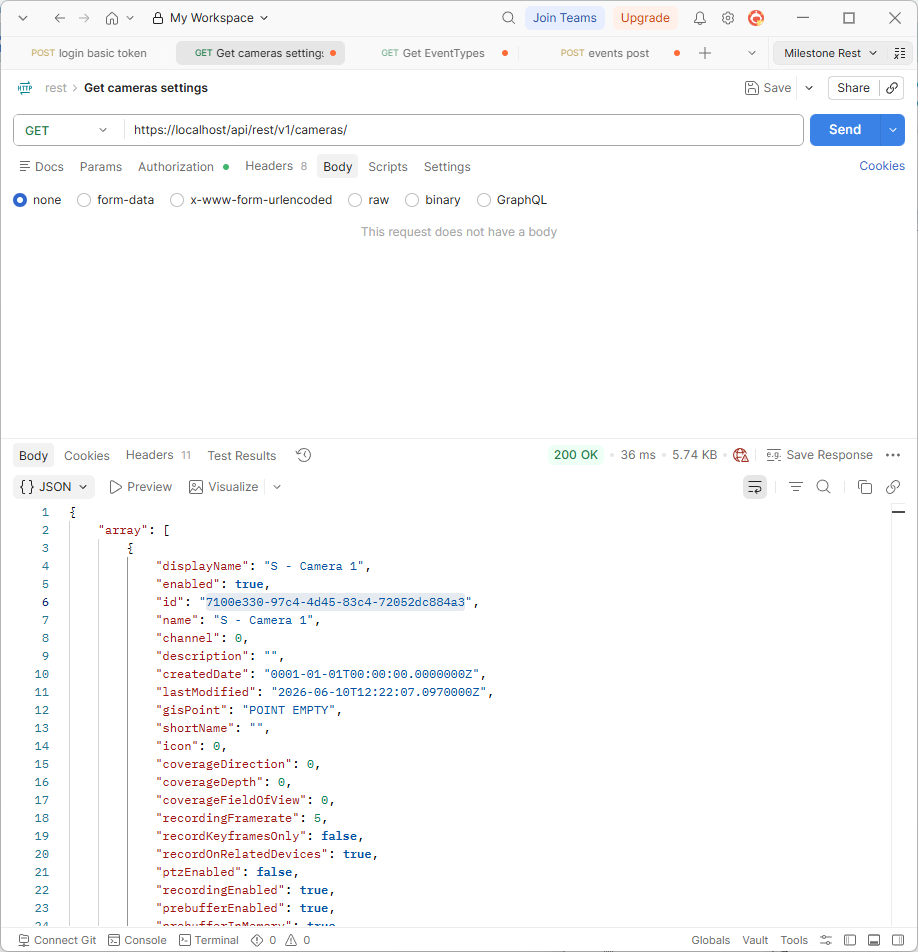

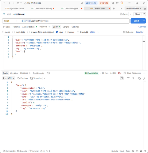

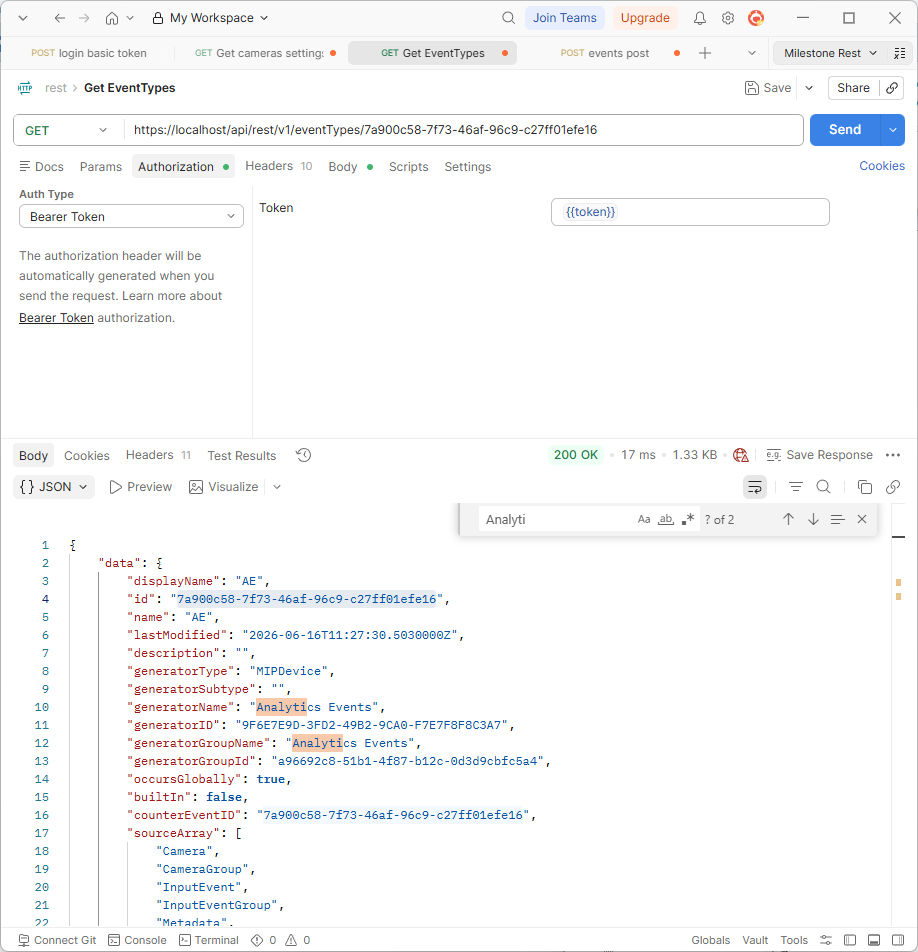

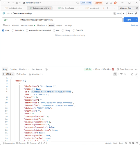

Let me give you some pictures trying to show the elements I used in my testing:

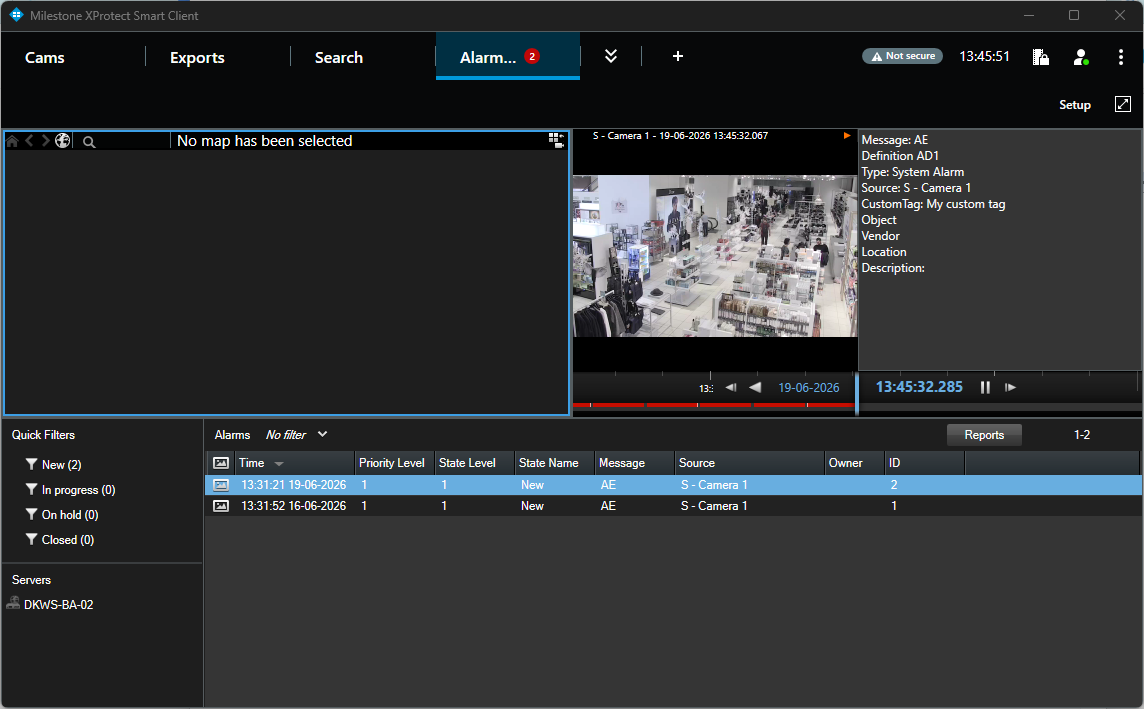

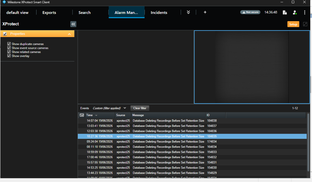

My events (and my soap event) appear in the “Alarm Manager” tile that I configured to display my events, Cf screen shot

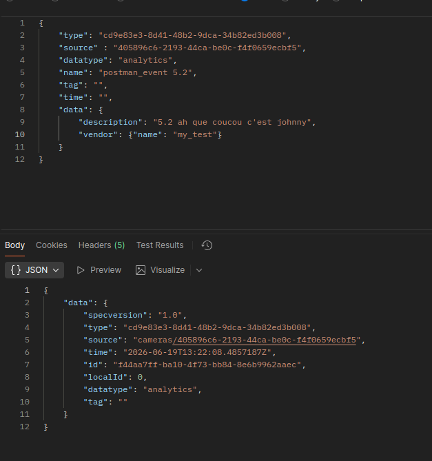

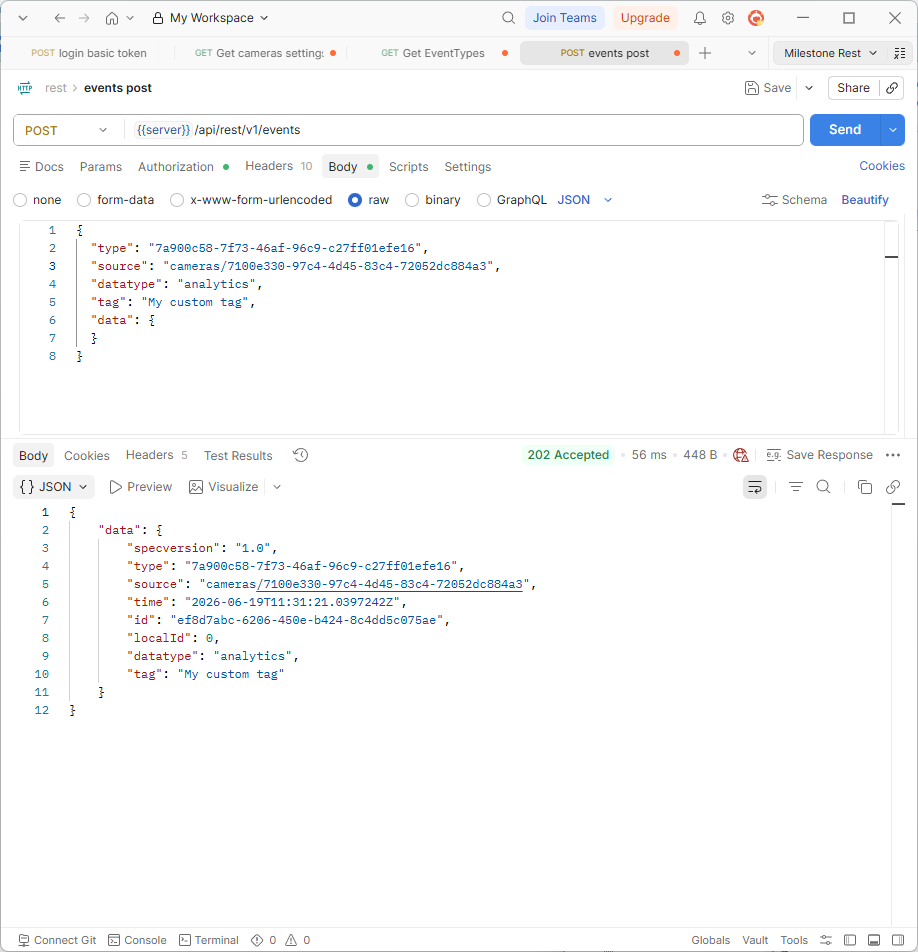

And for a postman request, that works but does not show me anything (and GET on the given ID returns a 404 :

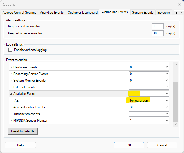

Please do a quick check. In the Management Client, Tools – Options - Alarms and Events tab, are the Analytics Events saved? (Retention > 0)
If they are not stored it will explain why the events are not shown in the Smart Client or returned on a GET.
That was it ….. Thank you so much.
We change the configuration at one point because we were receiving way too many events because of all the tests machines and we wanted to clear the events log…
