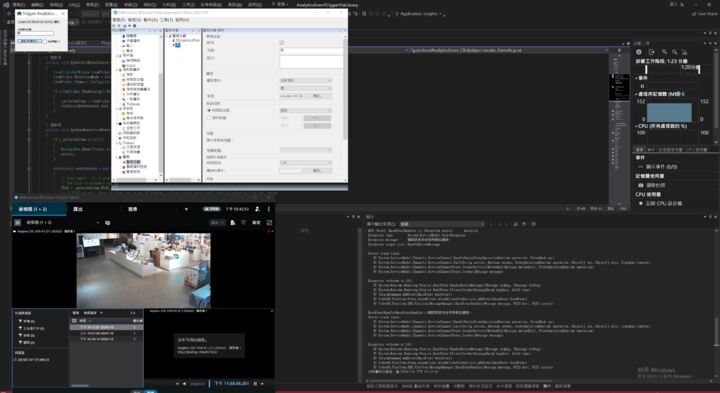

I used Analytics Event Trigger via library and after pressing the send button, I did not see the alert in the client alert manager tab. However, when I used XProtect Server to send the event, I could see it. BaseEventHandlerBaseEventHandler () appeared in the program detection to confirm that the message was safe. An error occurred during sex. How to explain?

I am in doubt whether you see an error or not. If you see an error maybe you could do a screen capture and show it here.

附上偵錯的照片

不管使用MyAnalyticsEvent01或是中文都沒辦法接收到訊息,但我可以選擇攝影機,這樣我應該不需要指定客戶端

No matter I use (MyAnalyticsEvent01) or (Chinese), I can’t receive the message, but I should choose the camera so that I don’t need to specify the client.
