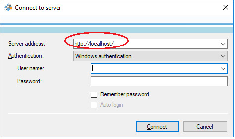

Let me ask you a silly question but did you login to your server when you saw the login dialog?
Yes I was able to login using the server IP address, and able to see my devices. Which when trigger an analytics event, gives me the error as above.
I don’t get why the error shows I’m pointing to a ‘localhost’ address when I am accessing the milestone server from a client. Shouldn’t it point to the server IP address? Are there any config setting in IIS where I’ll have to change?
