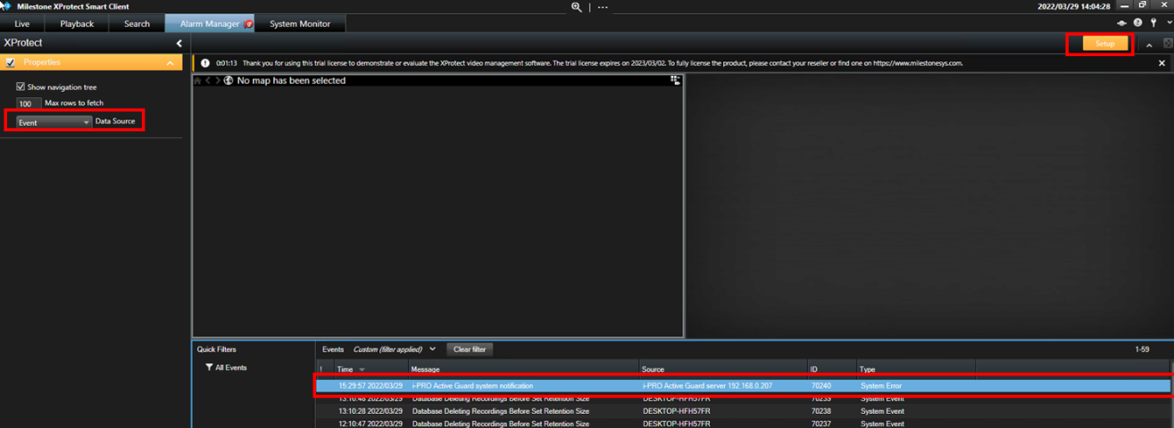

Analytics event without FQID is not shown in "Event" list on Alarm manager in XProtect 2025R2
It seems XProtect 2025R2 behavior has changed from 2025R1 or earlier. Is this expected update?

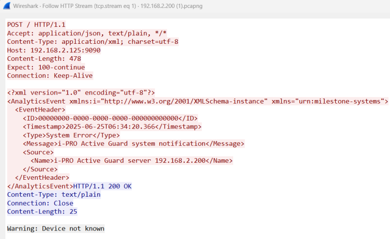

In 2025R2, when our software sends Analytics event, XProtect responds “Warning: Device not known”.
Analytics event has been registered on Management client.
In 2025R1 or earlier, the event is shown in the event list.
