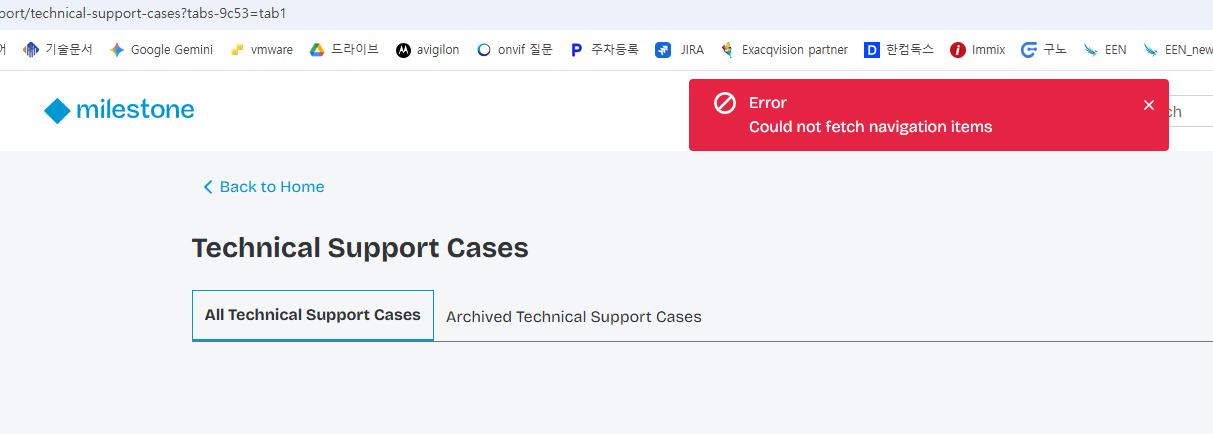

I’d like to contact technical support, but I’m getting an error like the one in the image. Is there something I’m missing?
Please try to accept all cookies and if you have an adblocker please try to disable it, try if it makes a difference.
Otherwise you will need to call Milestone hotline to get help with the login..
Is the Milestone hotline a support team?
I’ve already sent numerous emails to the email address at Contact Milestone Systems | Sales, Technical Support & other inquiries for help, but months have passed without a response.
This forum is specifically dedicated for questions concerning integration development and use on Milestone SDK and APIs.
I am sorry to hear you have had no response. Please try again. Perhaps try to call on the phone, they should be able to help with the login issue, it might be next step then to report the issue you have presented, but if you get help with the login that will be the right first step.
