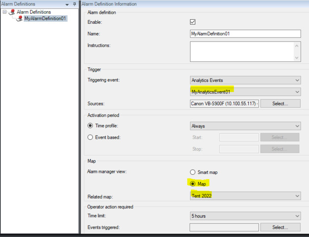

Start Management Client – Alarms – Add new alarm definition.
Select the event as Triggering event, and setup Related map. Then save the alarm definition.

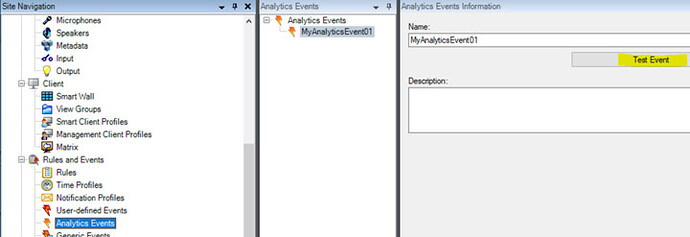

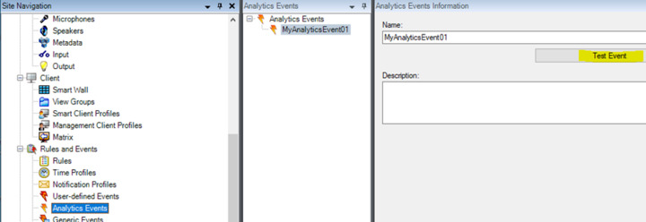

Go to Analytics Events and trigger Test Event from the event that you set up on the alarm definition in Alarms.

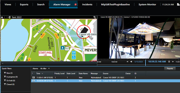

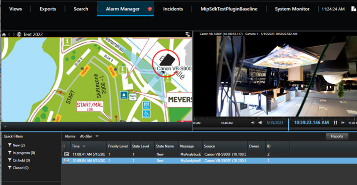

Start Smart Client. Go to Alarm Manager and you will see Map view of alarm.

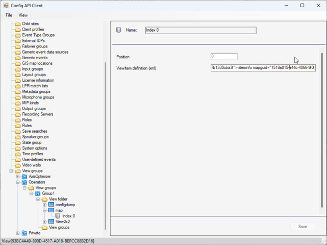

Better way to find the mapguid. Use the ConfigAPIClient and read a view where the map is used.
https://doc.developer.milestonesys.com/html/index.html?base=samples/componentsamples/configapiclient/readme.html&tree=tree_2.html
