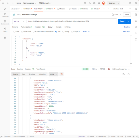

I admit I had to do some trial and error, but I figured how to do this.
When you can do a GET - /api/rest/v1/cameras/{id}/settings/
you can also do a GET- /api/rest/v1/settings/{id}
and on the latter, I learned, you can also do PATCH
I did a GET took the body parts from the response to do a PATCH
I found that this works in my example
“stream”: [
       "codec": "h264",
       "FPS": "11.0"
If updating the first two streams this work
“stream”: [
       "codec": "jpeg",
       "FPS": "10.0"
       "codec": "h264",
       "FPS": "11.0"
See it in another way:
thank you for this, I was close, just not in the right spot!
