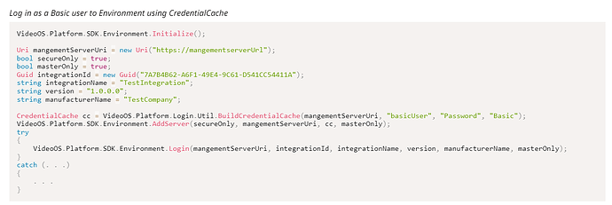

We are integrating with the API (API Gateway) for rule creation. To log in, we use the VideoOS.Platform.SDK.Environment.AddServer function together with the credential cache. Subsequently, to make a request to the API, we retrieve the cache using the login settings (LoggingSettingsCache.GetLoginSettings(hostname, port)).

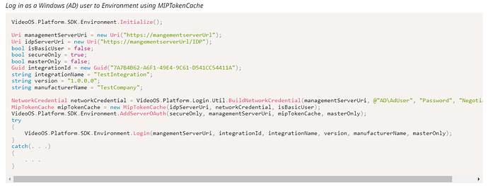

This has raised a question about the implications of logging in first with the credential cache and then extracting the token cache afterward. Would it not be better to retrieve the MIPTokenCache from the beginning and use it both for login and for API requests?

Perfect, thank you for your help. Even so, I still have some doubts about how the login works:
1. I understand that by using the SDK, if I log in as a basic user, the SDK is utilizing the IDP, correct?
2. And if I log in with an Active Directory user, would the SDK also be utilizing the IDP?
3. So, I’m left wondering what the difference is between the login shown above and the login with the MIPToken. Because as I understand it, both use the IDP?
4. Lastly, if I work in a federated architecture and my client authenticates on a site that has several child-sites, can I use the token I receive when registering on the parent site for the child-sites? For example, if the client wants to create a rule on one of the child-sites through the API Gateway, would I need to register on the child-site and receive a new token to then be able to create rules on it?
  1. Yes
  2. Yes
  3. The login will always use the IDP and OAUTH on any system supporting it (which all newer versions do), so under the hood all the scenarios you describe will end up being the same. The MipTokenCache is just a newer and more generally useful way of providing the credentials.
  4. You need to get a token for each site. You can ask MIP to do all the logins, but you still have to pick out the correct token from the login settings for each site.
