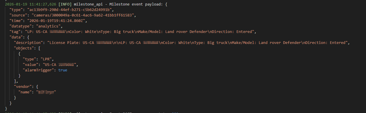

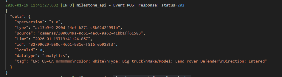

I’ve attached 2 images - One shows the event payload being sent to milestone, and another that shows the response from the milestone server. I’ve obfuscated the license plate characters

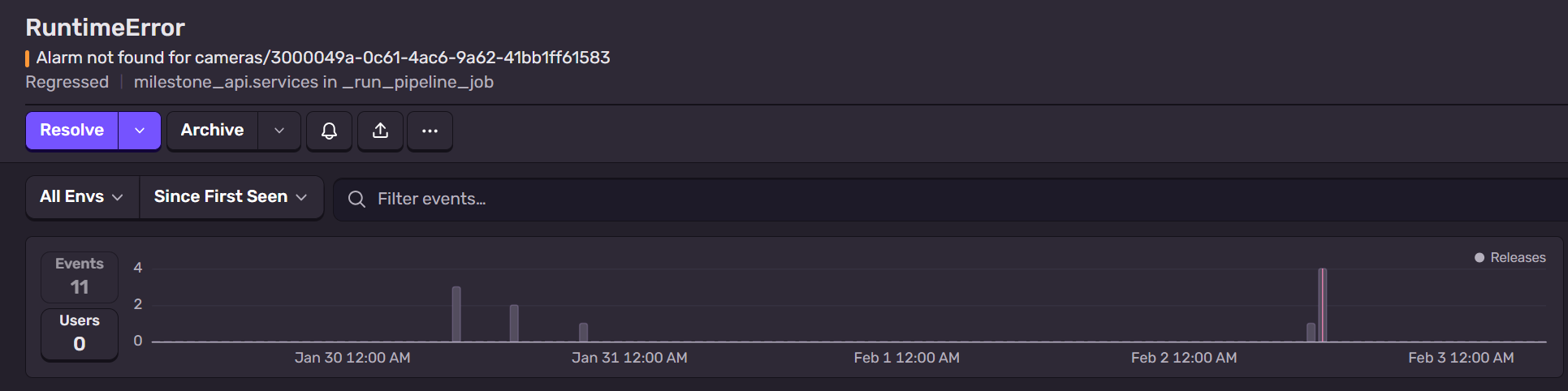

So just a update @Bo_Ellegard_Andersen - Setting up a analytic event for every alarm did not fix it. I just had a handful of missing alarm errors happen. But it does recover and go away on its own. There has been about 11 errors for that since last week. They seem to happen sporadically. I had 4 events happen just yesterday around noon.
