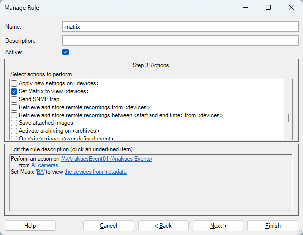

I have the same issue, where my rules is when the event is triggered, the action will be setMatrixView to one of the Matrix to display the live camera view.
I was trying to update this rules whenever I received an alert from 3rd alarm system, then I will update the value of matrix to the responsible PC and set the correct live camera to display the live view. Then, trigger the event so the rules can do my job without setting many rules in Milestone to fulfill my client’s requirement.
With this, any idea on how can I have another work around with update the rule? Much appreciated if you can provide the information. Many thanks!
Matrix is different in that it is supported. Introduced in 2023 R3. (I hope you can upgrade your version.)
Ref. https://doc.developer.milestonesys.com/html/index.html?base=gettingstarted/intro_configurationapi.html&tree=tree_4.html
Also, if you configure a rule that uses “the devices from metadata” and then trigger it with an analytics event, where the source is the camera you want to show, you do not have to create a new rule for every camera.. (But you will need a rule for each Matrix.)
PS. If you have more questions to this please create a new question here on the forum..
Also, I am running under 2023 R1 version.
