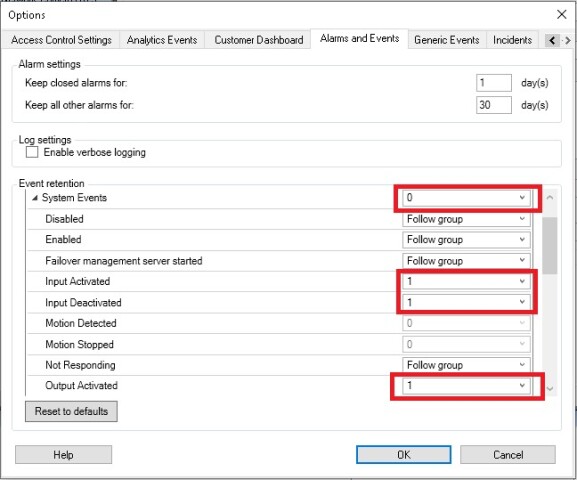

I have a realization. What the sample retrieves are events that are stored. Per default a lot of events are not stored in order to not overfill the database.
If you in the Management Client go into Tools- Options, the Alarm and Events tab, you can adjust retention on events. I guess this is what is needed to get meaningful output from the sample.

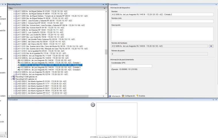

We are referring to the activation/deactivation of the inputs that a device/camera has when it is added to a recording (attached screenshot for more detail), not to the events or alarms generated manually in the tabs you refer to.

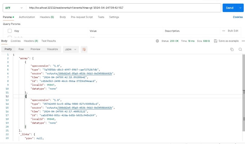

I’ve tried what you described, but with outputs not inputs (setting up camera inputs is a little bit more difficult in test environment).
First of all, I’ve set-up retention time as @Bo Ellegård Andersen (Milestone Systems)​ suggested you.
Because as you know, be default system events are with retention time set to zero.
(Management Client → Tools → Options → Alarms and Events tab)
Then I tested those events are showing in the SC (alarm plug-in).
(Smart Client → Alarm Manager tab)
And then tried with REST API (PostMan).
And all seems to work as expected.
