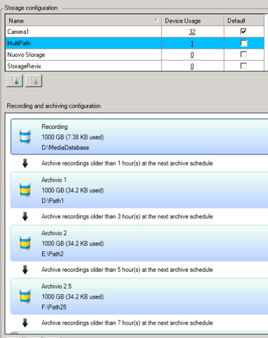

is it possible know through an event when Milestone XCO move recordings from live to archive storage?
In other words, there is an event triggered when Milestone move recording across archive in Storage configuration?
For example when XCO move recording from [D:\MediaDatabase](file:D:/MediaDatabase) (Recording) to [D:\Path1](file:D:/Path1) (Archivio 1).

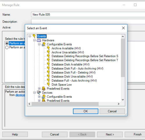

There is no event on a regular and successful archive.
There are events for rarer event like the disk is running full. See this screen capture from setting up a rule:
The events that can be used in rules or alarm definitions are also events that you can detect if you subscribe to NewEventsIndication. To experience how this works please explore the StatusViewer sample. (alternatively the Alarm and Event Viewer sample).
