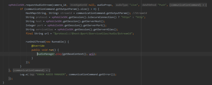

Hello People,
I will try using this example but I have a problem with AudioManager.play, (see Attach). Do you have any idea about this issue in my code? Do you have any implementation regarding the AudioManager to use the play method?
Thanks,
Dario
