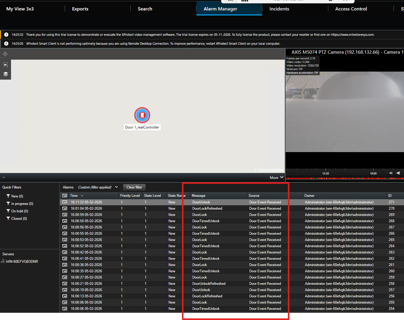

Area Arm/DisArm alarms are not appearing in 'Alarm Manager' tab of Smart client
I am able to receive an area arm/disarm event in smart client app under access control tab. However, I am unable to receive area arm/disarm event as an alarm in ‘Alarm Manager’ tab in smart client app.
I have configured separate alarm definition for area arm & disarm event. Also, I have configured an event rule for area arm and area disarm in milestone management client.
Please suggest a way to get area alarms in Alarm Manager tab.
Not getting area alarms -

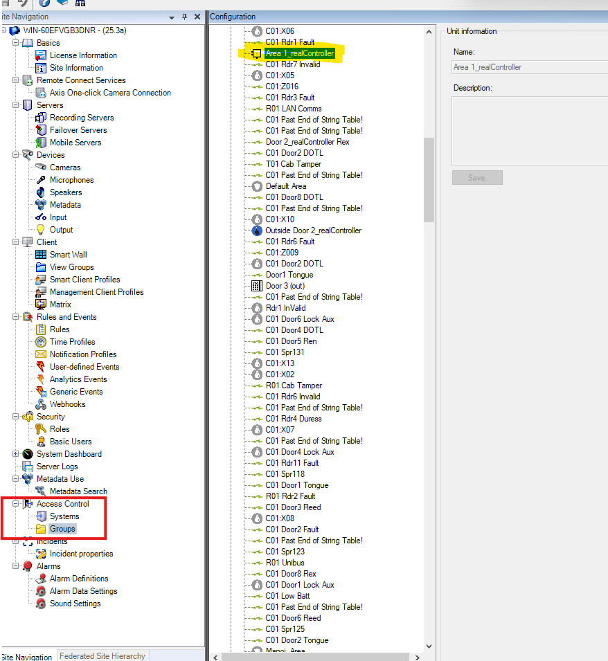

Hello Manoj, can you tell me how the area has been implemented in the Access Control integration? Is it an ACUnit or some other type of object?
We are currently investigating issues with Alarms and Access Control integrations, so the issue you’re encountering might also be related.
Yes, I am using area from an ACUnit. Below are configurations which I have done in Management client to get the area alarm in Alarm Manager of Smart client -
