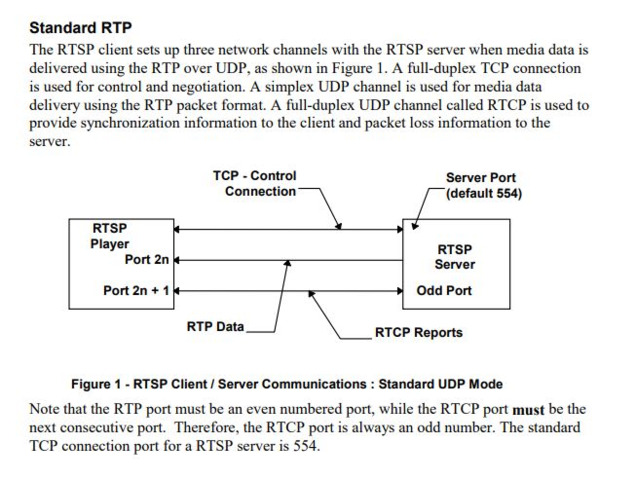

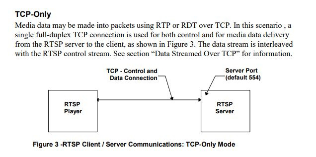

Hello Petar,
Reading on RTSP I saw that there are two modes :
Standard RTP
TCP Only
Which one(s) do to use in Open Network Bridge ?

Hi Jean-Jacques ,
RTSP server of the ONB (Open Network Bridge) supports both of them.
It is up to you to decide what to use.
Using UDP as transport usually allows lower delay as well as better network utilization on the cost of some (eventual) packet (frame) lost.
Using TCP (interleaved mode) as a transport aims for NO data loss, but on the cost of higher network consumption and higher delay.
You should consider which one fits better for your use case. For example if the stream is consumed only to be previewed on screen, you should freely use UDP.
Opposite, if the aim is to feed the media in the Analytic Application (AI, ML, etc) you probably would want to use TCP.
Of course underlying network should also be taken into account. Some corporate networks don’t allow UDP traffic and in that case you will be forced of using UDP.
In general, if there are no specific requirements and the Network’s capacity and quality are enough for the media streams you want to fetch, it should not matter at all.
