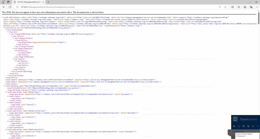

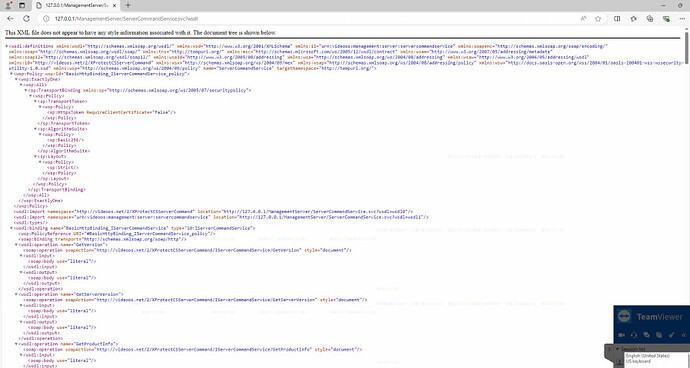

I asked them to confirm whether they are using SSL or if they are missing the ServerCommandService WSDL which seems to exist. Does anything look off here?
Who can we escalate this to get this company connected?
If it isn’t the version maybe there is something different or special about the setup. SSL is one idea, but I guess that was as expected..
The WSDL looks as expected, cannot detect anything wrong on that.
