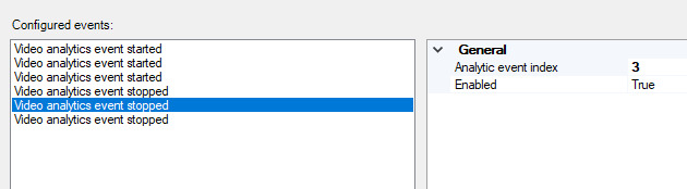

To receive events from a camera I set up events in Management Cliente like this:

When I launch test alert eg. Gunshot from camera I receive a message with type 'AnalyticsStart`. When I next trigger test Aggression alert from camera I receive almost identical message 'AnalyticsStart`. The message does not contain ‘Analytic event index’, so I cannot differentiate what event type was triggered.

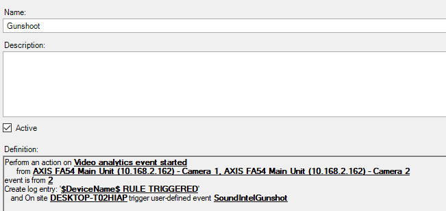

My other approach was to create Rules like this:
but then, when I receive a message in code Source property is “Kind.TriggerEvent” and I lost information which camera triggered the event.

The NewEventsIndication misses the information about the “Analytics event index”. The functionality to include this information was never implemented.
The same issue can be see Motion Started (HW) events from the camera, here you can configure up to four “Motion Window” that you can use in rules, but you cannot get the information from NewEventsIndication.

Until the release the only workaround I can see is the rule you outline, but you will have to make one user-defined event and one rule for each camera, so that when you get the user-defined event you know both the camera and the “Analytics event index”.
