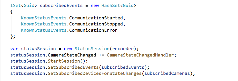

Currently, we are using the StatusSession class from VideoOS.Platform.SDK.StatusClient. We initialize one StatusSession for each Recording Server and subscribe to the CameraStateChanged event (attached the code snippet). This works correctly in some deployments, but in some sites/NVRs we are not receiving any status events. We suspect this may depend on VMS configuration differences.

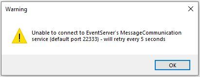

While trying to connect using StatusViewer sample, below attached warning message is shown. After clicking OK, the StatusViewer sample loads and the cameras are listed, but none of the events are triggered.
Could you please advise on the cause of this issue and how we can resolve it?
Thank you.
Try to troubleshoot using this knowledge base article - https://supportcommunity.milestonesys.com/KBRedir?art=000033110&lang=en_US

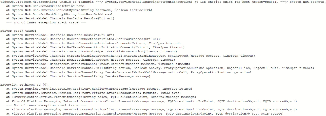

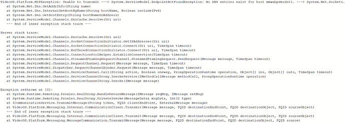

While requesting for current camera states using below code,
_messageCommunication.TransmitMessage(new Message(MessageCommunication.ProvideCurrentStateRequest), null, null, null);
below attached MIP Exception is thrown. Kindly advise.
In the first line the hostname is mentioned, is that what you used when you used the knowledge base article? I have a hunch that the issue might be DNS, that the hostname does not connect.
In Management Client, Tools, Registered Services, look at the Event Server, is the registration correct there?
