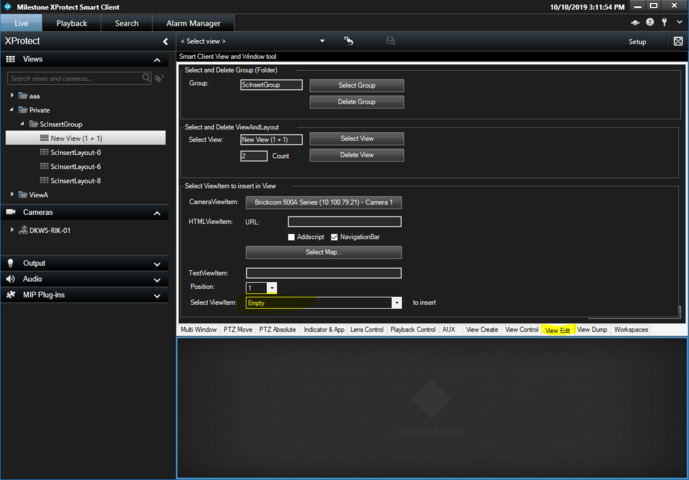

Run the Smart Client View and Window Tool plugin sample and the View Edit.
https://doc.developer.milestonesys.com/html/index.html?base=samples/smartclientview_windowtool_sample.html&tree=tree_search.html?search=smart+client+view+and+window+tool
Then you can use
_viewAndLayoutItem.InsertViewItemPlugin(..)
and using this you can insert a blank ViewItem.
