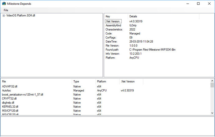

Hi, we are migrating our C# Windows application to 64-bit and we are having some conflicts when using the Milestone SDK. I downloaded the latest version and since I couldn’t find anything specific for 64-bit I assume it would work, but still doesn’t. I checked the details for the dlls in the package with a tool called pstudio and it returns it has been compiled on 32-bit (check attached image for Videos.platform.sdk.dll)

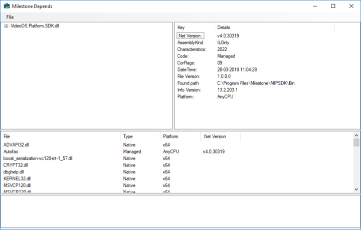

I do not know pstudio, and I did not find on a simple Google search. I trust the Mdepends tool that Milestone supply with the MIP SDK (find it at [C:\Program](file:C:/Program) Files\Milestone\MIPSDK\Tools\MDepends (if you have MIP SDK installed)).

Sorry, I missed the second part of your message. I just checked with MDepends as you suggested and I do get the same results than you, so I really don’t know where is the problem now…
