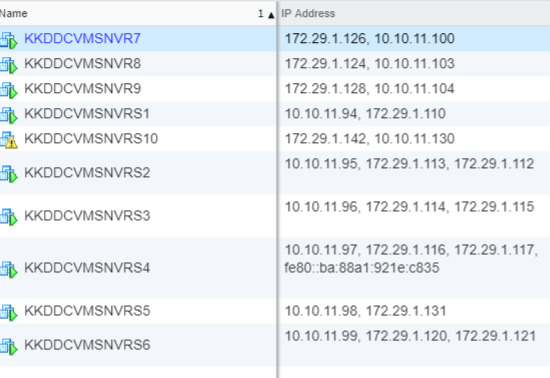

Hi @Peter Posselt Vergmann (Milestone Systems) Thanks for sharing the details. We have total 5 recording servers in my setup and configured with 400 cameras in these servers. I am having the following queries in executing the recorderstatusservice2.asmx?wsdl.
- I would like get health status of all 400 cameras do i need to access recorderstatusservice2.asmx?wsdl from each and every recording server?
- What is the SOAP method which will provide the camera connected /disconnected status.
- Can i use the GetCurrentDeviceStatus method?
- How can get the guid values for all cameras?

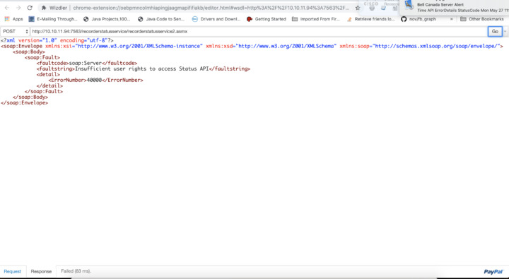

Yes, token was generated using the user that was added in the VMS.
@Syed Adil (Milestone Systems) @Kakinada Smart city
The user needs to have access rights for the Status API. So either he will have to be an admin or you can provide the rights under Roles//Overall security/Management Server/Status API

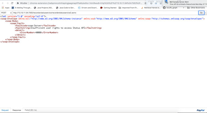

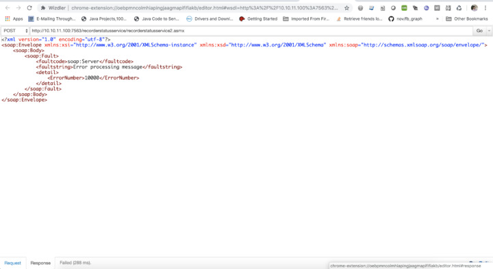

After updating the user privileges getting below error.
Based on the error I would assume that you are missing or have some incorrect parameters, but without know your actual request it is hard to say.

recorderstatusservice2.GetCurrentDeviceStatus response
<?xml version="1.0" encoding="utf-8"?>
<soap:Envelope xmlns:xsi="http://www.w3.org/2001/XMLSchema-instance" xmlns:xsd="http://www.w3.org/2001/XMLSchema" xmlns:soap="http://schemas.xmlsoap.org/soap/envelope/">
<soap:Body>
<soap:Fault>
<faultcode>soap:Server</faultcode>
<faultstring>Error processing message</faultstring>
<detail>
<ErrorNumber>10000</ErrorNumber>
</detail>
</soap:Fault>
</soap:Body>
</soap:Envelope>
@Peter Posselt Vergmann (Milestone Systems) @Kakinada Smart city @Syed Adil (Milestone Systems)
Please review the attached code snippet.
Why does it say “[string?]” where the device guid should be supplied? You need to provide the actual guid of a device.
@Peter Posselt Vergmann (Milestone Systems) @Syed Adil (Milestone Systems) @Kakinada Smart city
In the documentation as it mentioned as optional i just leave it as it is. Let me try to use the actual guid and try once.
