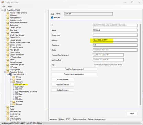

My answer will be a general tip. There is a sample that is more a tool than a sample. If you run the Config API Client sample you get an overview of the structure of configuration. I was quickly able to find the following which might be the best answer to your question..
https://doc.developer.milestonesys.com/html/index.html?base=samples/componentsamples/configapiclient/readme.html&tree=tree_2.html

HardwareDriverSettingsFolder is wrong. What you are looking for is a property on the Hardware itself.
What is the command to get a property for the Hardware itself for a protocol integration/using the SOAP API?
.GetItem(“Hardware[f2cc9aa1-717e-461a-99a3-fea87e4e3a98]”); (with correct GUID)
You will get an object containing Address in the Properties.

I must suspect that you are not doing a .GetItem(“Hardware[]”)
I do suspect that you are doing a .GetItem(“Hardware]/CameraFolder”), which is not what you need.
I am doing .GetItem(“Hardware[]”) but the result just lists all of the child paths. As you see above this includes Hardware]/CameraFolder, Hardware]/MicrophoneFolder, etc. I chose not to list all of them out but it includes all child paths of Hardware[] and their properties
My new theory.
I do suspect that you are doing a .GetChildItems(“Hardware]”) (which is not what you need).
Are we getting closer?
Bo, that theory was correct! My apologies for the confusion and simple mistake, thanks for your help!
