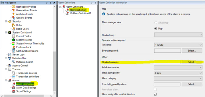

One camera can trigger for one alarm, that is why there is no list for alarms. However there is related cameras. Please see this Management Client setup in Alarms –
If you want to get this “related cameras” then you might want to use this property –NOTE: If you are talking about Alarm definitions, then please see ConfigAPI Client.
