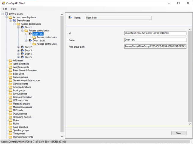

Unfortunately there is no way to access the cofiguration. However it is possible to read door and options through the ConfigAPI sample, please see this link, I hope it would be helpful –
https://doc.developer.milestonesys.com/html/index.html?base=samples/configapiclient.html&tree=tree_2.html
