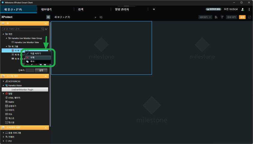

Hello, I would like to know if there is a way to add a menu item in the context menu displayed in the image I attached.
No, this is unfortunately not available as a MIP plugin option.
I would like to present the idea to Milestone Product Management as I think it is the first time I have been asked. However, before I do so; can you tell me more about the use case you have envisioned where a plugin in this place would be useful?
I would like to provide a user with a menu that copies the tile configurations from the existing view item or the entire layout. For example, if there is a 4x4 layout and 10 video channels are being monitored, then when a user clicks the menu, it would copy the 4x4 layout and the monitored tiles into our plugin’s designated view item.
