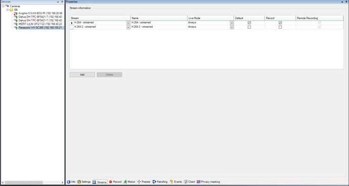

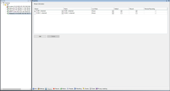

I am trying camera with dual streams, but ONB only created 1 stream.
my camera support dual streams:

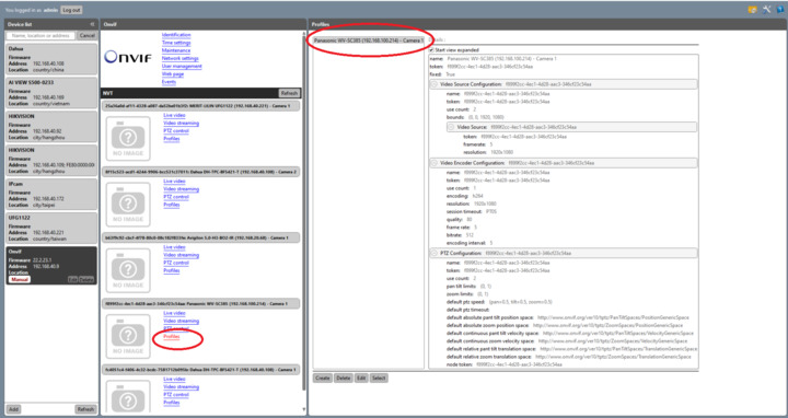

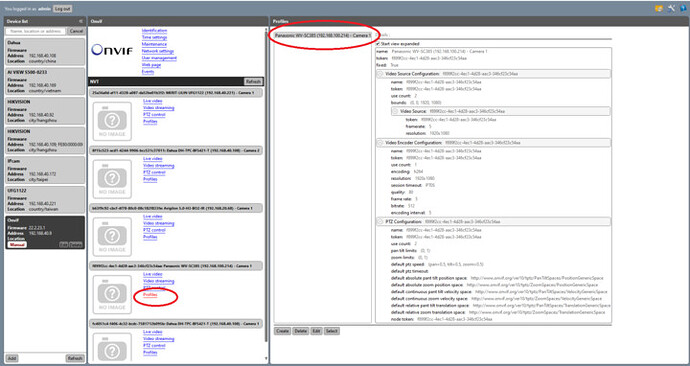

but in ONVIF device manage, only 1 stream:
Please see below Administrator Manual page 8, it says “If a camera supports multiple streams, only the default stream is sent. “, so this is by design.
https://doc.milestonesys.com/mc/pdf/2022r1/en-US/MilestoneOpenNetworkBridge_AdministratorManual_en-US.pdf
Actually this concerns how configuration information is returned on the ONVIF interface.
In the RTSP service you can refer to the different streams by adding “/<stream_index>” at the end of the RTSP address.
