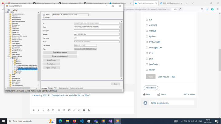

Please run ConfigAPI Client sample and select a camera. As you can see below, you will get the date. Please explore the sample.
https://doc.developer.milestonesys.com/html/index.html?base=samples/componentsamples/configapiclient/readme.html&tree=tree_2.html
I am using 2022 R2. That option is not available for me Why?

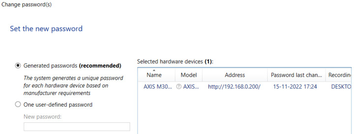

The “Password Last Changed” field is new in 2022R3 and doesn’t exist in 2022R2 or older versions. There is no way to get this information if the XProtect server is an older version.
