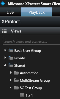

Camera groups and views are needed by clients to reconstruct the tree structure that you can find in Smart Client.
