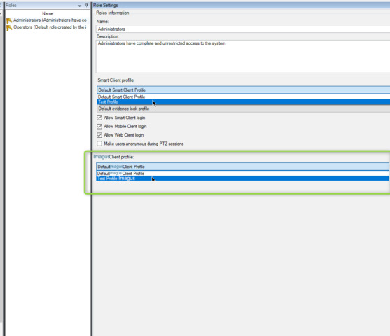

Hi Peter and Xinshuang, thanks for following up my question. I wonder, instead of modifying Smart Client Profile, in the Role Settings, are there anyway for us to show a list of selection of our own settings profile, similarly to the way you have done for Smart Client Profile, something like what I make up in the attached picture. and upon login in to smart client, we can populate the correct profile related to the user?
Hi Tram

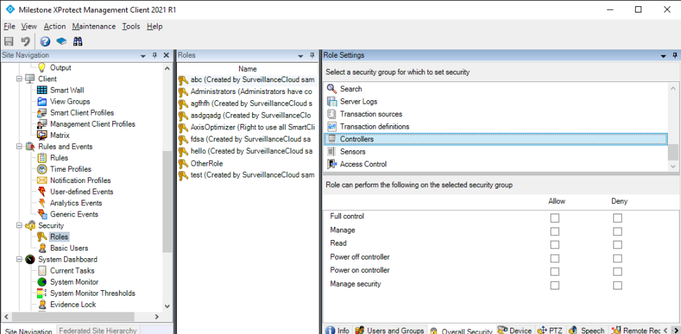

Unfortunately you cannot extend that part of the roles either. Only option regarding this is to use the authorisation functionality as showcased by the Sensor Monitor sample, which would allow you to add settings under the Overall Security tab on the roles. Maybe you can then add the functions you have as individual checkmark settings that can be enabled/disabled for each role?
https://doc.developer.milestonesys.com/html/index.html?base=samples/pluginsamples/sensormonitor/readme.html&tree=tree_1.html
