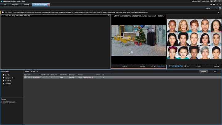

Can Protocol Integration can send the image(jpg,png) to the Analysis event ?
Hi Milestone,
I has successful to send the Analysis event from “Protocol Integration Sample - Analytics Event Trigger via XML” and “Component Integration Sample - Library Event Generator”
I found the sample on ​Component Integration can send the image include in the analysis event, But it can’t find this function on Protocol Integration Sample.
Our program is Java base, if it can use Protocol Integration to send the analysis event with image will be more convenience for us.
Is it possible to use Protocol Integration to send the Analysis Event with image like the Component Integration Sample ?
And if there has any suggest to integrate Milestone SDK on Java ?
Below is my successful screen about send the event with image.
