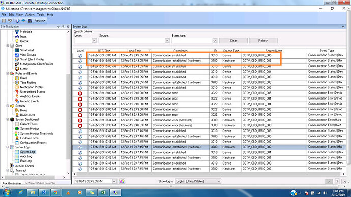

we have configured the device event(Responding & Not Responding ) for the camera.But i am getting multiple alarm like hardware and device for the same camera at same time, hence we are unable to generate camera health report .

we are facing problems with the repeated event for same device at time .
Can you make me understand why are we getting device event and hardware event for same camera at a time .
A hardware device might have multiple “devices”, multiple cameras channels or similar. Are you getting conflicting events?

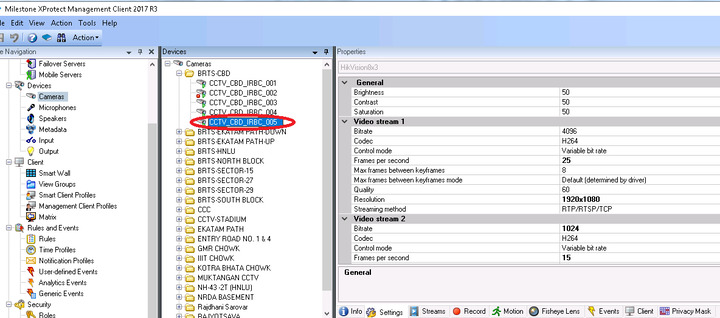

Please try to describe the device and what you observe. It might be a good idea to include a screen capture of the Management Client showing the device and settings as this could help me understand.
We have one only one channel one camera .
The alarm has been highlighted red in image
A hardware device will have one or more video devices, but also possibly audio, input, output “devices”. So in this sense a hardware device is the parent of one or multiple other devices.
Please note that your screen capture show that the hardware and the camera starts (communication established), there is no confusion or conflict.
