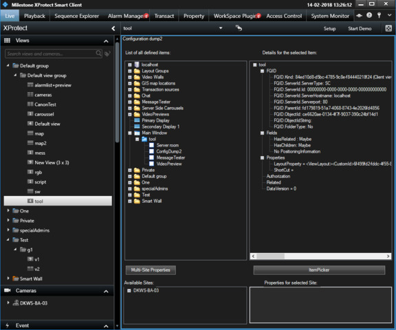

If I use the Config Dump tool plugin sample I can see..
There you have that currently the Main Window is displaying the view named tool and it has four view items.
I figure this is what you need. If it fits explore the sample.

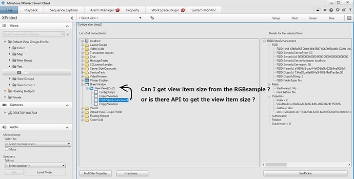

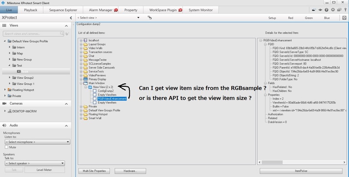

We are developing the new plugin by reference to RGBVideoEnhancement sample plugin.
If the plugin create one of four views is there API to get the view item size ?
