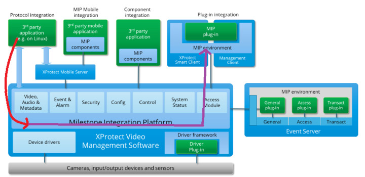

So, I did some tests. here with what I did, and what I understood to do what I want :
I created a Ptyhon script from what I found as exemple, to access to the MIP and get list of camera. (The red line).

But now, as far as understood, I have to use “Access Module” to access to the “MIP environment” and communicate with the “Samrt client”… Purple line.
Is that correct ?
How to do that ?

Access Control Module is a framework for integrating Access Control into XProtect. I believe it is not what you want for the task at hand.
For the task of making the Smart Client (SC) do stuff that is not done by the end-user it will require that you develop a Smart Client plugin. I think you should have a look at the Smart Client View and Windows tool plugin sample for that.
