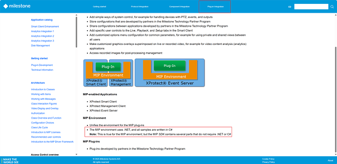

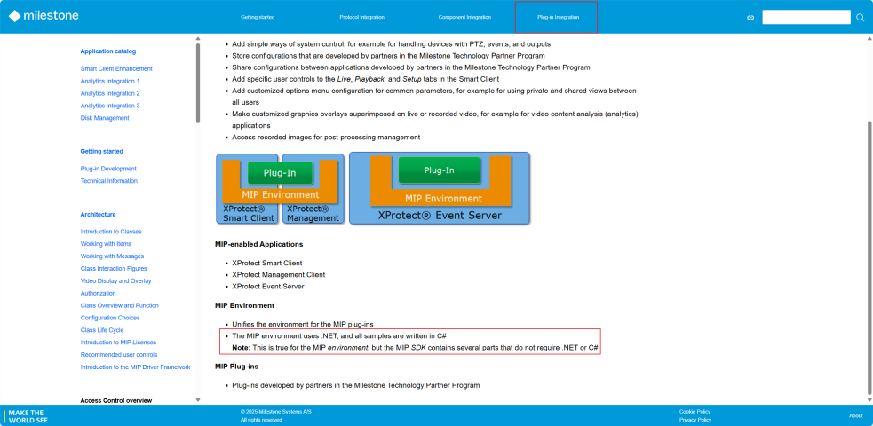

I found this documentation from (MIP SDK Documentation).​
This is an old part of the documentation, this is written when the only .NET is what we today know as .NET Framework.
Still I will discuss with Milestone Development whether to change this. Thank you for finding the example when I asked.
