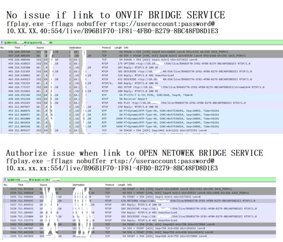

Please find the screenshot captured with wireshark. It is no issue when link to ONVIF bridge but have authorization issue when link to Open Network Bridge issue.
We confirmed the user id and password used for Open Network Bridge is correct. It is no problem to open RTSP video using VLC when key in the same user id and password at the popup window.

In Open Network Bridge 2020 R3 we have introduced the more secure digest mechanism that uses SHA-256, so now when a request that needs authentication is made we respond with both MD5 and SHA256 WWW-Authentication headers.
Unfortunately it look like the ffplay does not support that. So, will it be an option for you to use the old version of the Onvif Bridge?
