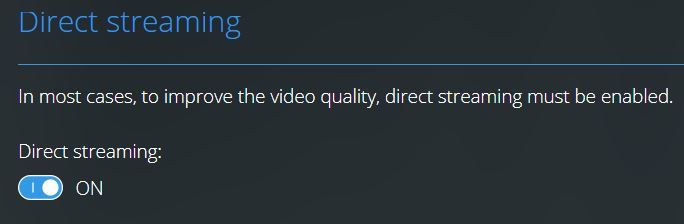

To verify that’s the problem, can you give us some more info:
- when you open WebClient and go to settings page, do you see ‘Direct streaming’ and is the toggle On, as shown in the attached image?
- when both ‘Direct streaming’ and ‘Video diagnostics overlay’ are enabled in WebClient, what is the codec and streaming type that you see in camera thumbnails in WebClient?
Ok. Direct streaming is not even an option under settings
Good, we’re slowly progressing…
Now can you tell me what XProtect distribution do you use - Corporate, Essential or some other?
According to our documentation, ‘Direct streaming’ is only available in Expert and Corporate so if you don’t have it there’s no way to make that particular sample working.
