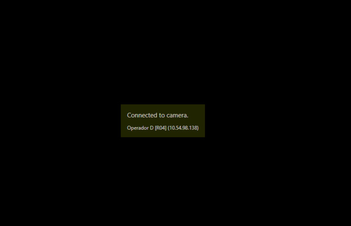

I’m showing a camera feed and it only works once.
When I set another FQID it doesn’t show any video only a message saying it has connected.

Bo, sorry for the late answer. I tested the approach that you suggested in that thread but it keeps failing. When switching between different cameras, the first time the ImageViewerControlForm works fine, but the second time it doesn’t get the feed. It shows a black screen withe live information saying it has connected but it doesn’t show the live video.
