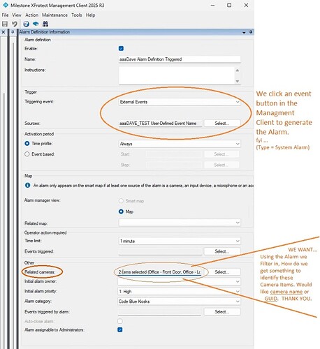

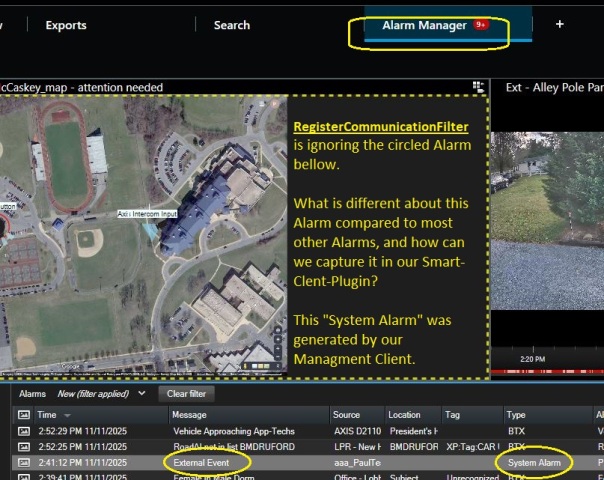

The plug-in works fine for “regular” alarms, but our NewAlarmMessageHandler()
never receives the circled “System Alarm” (JPG bellow). This Alarm is generated from an Alarm Definition with an Event-Button in the Management Client.
How can we detect such an Alarm?
Please review the Yellow notes added to this Smart-Client screen shot.
You will have to add some detail about how the alarm is triggered, it is unclear to me. Please give me the details on how the event and alarm definition are setup. I would like to test with your instructions to make sure I do the same. If I can reproduce I can analyze.
Please also mention which version the XProtect VMS and Smart Client is.

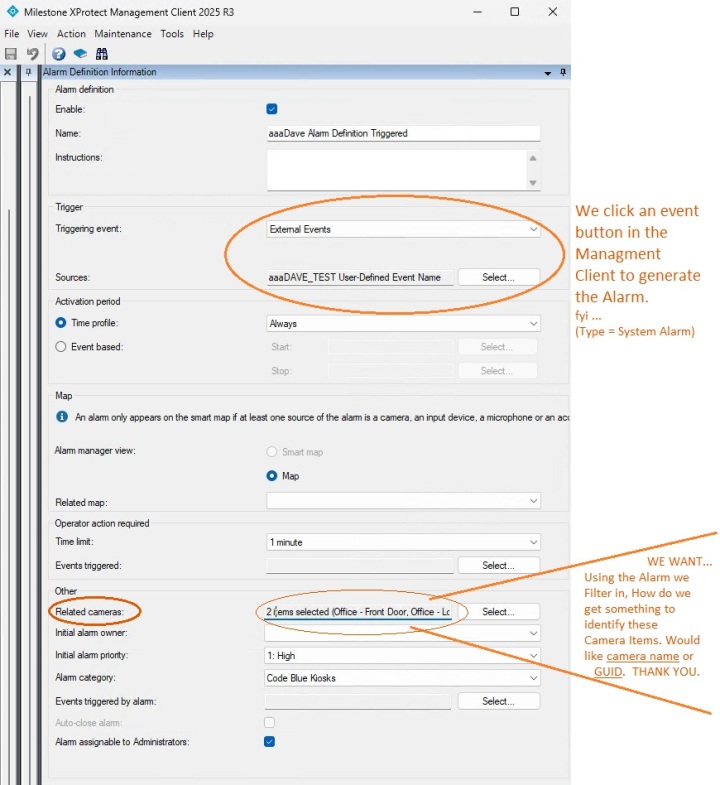

Adding to my recent email to you Bo, is this Alarm Definition screen shot

To retrieve all the cameras mentioned in the Alarm Definition’s "OtherRelated Cameras"is the goal.
Using the REST API to retrieve all these cameras might be perfect.
Hoping to get all the cameras, not just one.
“CameraId” might not be the right thing.
We’re looking for ALL the “Related Cameras”, camera names or GUIDs.

I recently discovered: we have been receiving the System Alarm all along in our Smart-Client’s RegisterCommunicationFilter.
But we still need a way to look up the camera item from Alarm-data.
(For better info, look at the screen shot preceeding this post above)

The problem was the camera lookup was failing. And we are now trying to find out how to get the CameraID (or other camera identifier) from the Alarm. The bug I discovered was that we were trying to look up the camera from the alarm-source field where we usually get the camera name. But the System Alarm’s Source field contains something other than the camera name in this Alarm.
Clarification.
The Analytics Event can have one source, if the source is a user-defined event then it cannot be a camera. I have an idea that if you say it works for some and not for others, those that it works for might have the camera as source directly.
That the Source cannot be used directly leaves Related Cameras and these can be read on the Alarm as ReferenceList. (I am assuming you have used the MIP library and not need to switch to RestAPI.)
https://doc.developer.milestonesys.com/mipsdk/?base=MIPhelp%2Fclass_video_o_s_1_1_platform_1_1_data_1_1_alarm.html&tree=tree_Search.html
For a view of how it looks try to run the Alarm and Event Viewer sample, put a breakpoint where it has gotten the Alarm object in line 336 (MainForm.cs), and see the Alarm object and the ReferenceList on an alarm that has this. You might be able to skip this and just put a breakpoint in your plugin code, but as I do not know your plugin code there is an element of guessing here.
