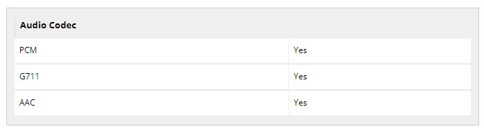

Here is the device page, please see this link and find Audio Codec - https://www.milestonesys.com/community/business-partner-tools/supported-devices/supported-device/?deviceId=49351&platform=XPCO&backCloses=true
It seems, the codes that you wrote on the post are not supported.
