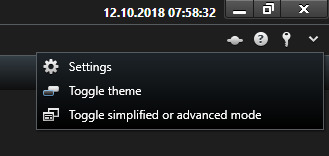

Now, is it possible to add an option to this Menu?:
Could not find any Sample to do that.
Since this is quite unrelated to your previous question I would normally ask you to post it in a separate thread to make it easier for others to find, so please do that next time.
You cannot add to that specific menu, but you can add your own buttons to the toolbar right below the menu. Look at the “Smart Client Toolbar Plug-in” sample. You can also add you own tab to the Settings dialog - look at the “Smart Client Settings Panel Plug-in” sample.
