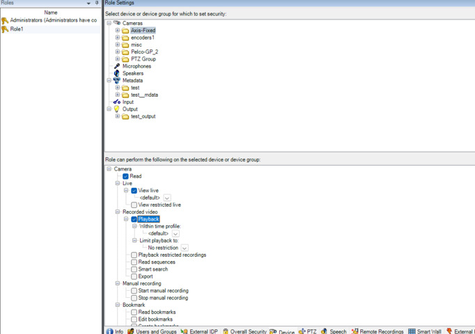

When live /playback On
Camera object ChangeSecurityPermissions properties21-12-2023 01:36:17.684 - EXPORT----False
21-12-2023 01:36:17.684 - GENERIC_READ----True
21-12-2023 01:36:17.684 - PLAYBACK----True
21-12-2023 01:36:17.684 - READ_BOOKMARKS----False
21-12-2023 01:36:17.684 - START_MANUAL_RECORDING----False
21-12-2023 01:36:17.684 - VIEW_LIVE----True
21-12-2023 01:36:17.684 - GENERIC_WRITE----False
21-12-2023 01:36:17.684 - VIEW_RESTRICTED_LIVE----False
21-12-2023 01:36:17.684 - PLAYBACK_RESTRICTED_RECORDINGS----False
21-12-2023 01:36:17.684 - READ_REMOTE_RECORDINGS----False
21-12-2023 01:36:17.684 - READ_SEQUENCES----False
21-12-2023 01:36:17.684 - SMARTSEARCH----False
21-12-2023 01:36:17.684 - CREATE_BOOKMARKS----False
21-12-2023 01:36:17.684 - EDIT_BOOKMARKS----False
21-12-2023 01:36:17.684 - DELETE_BOOKMARKS----False
21-12-2023 01:36:17.684 - CREATE_EVIDENCE_LOCK----False
21-12-2023 01:36:17.684 - READ_EVIDENCE_LOCK----False
21-12-2023 01:36:17.684 - DELETE_EVIDENCE_LOCK----False
21-12-2023 01:36:17.684 - CREATE_RESTRICTIONS----False
21-12-2023 01:36:17.684 - READ_RESTRICTIONS----False
21-12-2023 01:36:17.684 - DELETE_RESTRICTIONS----False
21-12-2023 01:36:17.684 - STOP_MANUAL_RECORDING----False
21-12-2023 01:36:17.684 - AUX_COMMANDS----False
21-12-2023 01:36:17.684 - PTZ_CONTROL----False
21-12-2023 01:36:17.684 - ACTIVATE_PTZ_PRESET----False
21-12-2023 01:36:17.684 - MANAGE_PTZ_PRESET----False
21-12-2023 01:36:17.684 - MANAGE_LOCK_PTZ_PRESET----False
21-12-2023 01:36:17.684 - RESERVE_PTZ_SESSION----False
21-12-2023 01:36:17.684 - RELEASE_PTZ_SESSION----False
21-12-2023 01:36:17.684 - DELETE_RECORDINGS----False
21-12-2023 01:36:17.684 - LIFT_PRIVACY_MASKING----False
21-12-2023 01:36:17.684 - DEVICELIVEVIEW----Default
21-12-2023 01:36:17.684 - DEVICERECORDEDBROWSE----Default
21-12-2023 01:36:17.684 - DEVICERECORDEDBROWSETimeBackward----0
21-12-2023 01:36:17.684 - DEVICEPTZPRIORITY----False

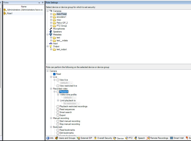

But the same when live /playback off
Camera object ChangeSecurityPermissions properties21-12-2023 01:34:11.534 - EXPORT----False
21-12-2023 01:34:11.534 - GENERIC_READ----True
21-12-2023 01:34:11.534 - PLAYBACK----False
21-12-2023 01:34:11.534 - READ_BOOKMARKS----False
21-12-2023 01:34:11.534 - START_MANUAL_RECORDING----False
21-12-2023 01:34:11.534 - VIEW_LIVE----False
21-12-2023 01:34:11.534 - GENERIC_WRITE----False
21-12-2023 01:34:11.534 - VIEW_RESTRICTED_LIVE----False
21-12-2023 01:34:11.534 - PLAYBACK_RESTRICTED_RECORDINGS----False
21-12-2023 01:34:11.534 - READ_REMOTE_RECORDINGS----False
21-12-2023 01:34:11.534 - READ_SEQUENCES----False
21-12-2023 01:34:11.534 - SMARTSEARCH----False
21-12-2023 01:34:11.534 - CREATE_BOOKMARKS----False
21-12-2023 01:34:11.534 - EDIT_BOOKMARKS----False
21-12-2023 01:34:11.534 - DELETE_BOOKMARKS----False
21-12-2023 01:34:11.534 - CREATE_EVIDENCE_LOCK----False
21-12-2023 01:34:11.534 - READ_EVIDENCE_LOCK----False
21-12-2023 01:34:11.534 - DELETE_EVIDENCE_LOCK----False
21-12-2023 01:34:11.534 - CREATE_RESTRICTIONS----False
21-12-2023 01:34:11.534 - READ_RESTRICTIONS----False
21-12-2023 01:34:11.534 - DELETE_RESTRICTIONS----False
21-12-2023 01:34:11.534 - STOP_MANUAL_RECORDING----False
21-12-2023 01:34:11.534 - AUX_COMMANDS----False
21-12-2023 01:34:11.534 - PTZ_CONTROL----False
21-12-2023 01:34:11.535 - ACTIVATE_PTZ_PRESET----False
21-12-2023 01:34:11.535 - MANAGE_PTZ_PRESET----False
21-12-2023 01:34:11.535 - MANAGE_LOCK_PTZ_PRESET----False
21-12-2023 01:34:11.535 - RESERVE_PTZ_SESSION----False
21-12-2023 01:34:11.535 - RELEASE_PTZ_SESSION----False
21-12-2023 01:34:11.535 - DELETE_RECORDINGS----False
21-12-2023 01:34:11.535 - LIFT_PRIVACY_MASKING----False
21-12-2023 01:34:11.535 - DEVICELIVEVIEW----
21-12-2023 01:34:11.535 - DEVICERECORDEDBROWSE----
21-12-2023 01:34:11.535 - DEVICERECORDEDBROWSETimeBackward----
21-12-2023 01:34:11.535 - DEVICEPTZPRIORITY----False
when we read it is blank/empty, why its providing empty?
It should have been Default/Always
when we copy camera ChangeSecurityPermissions from one camera to another camera, we get the error - “ChangeSecurityPermissions exception - Value cannot be null.”
