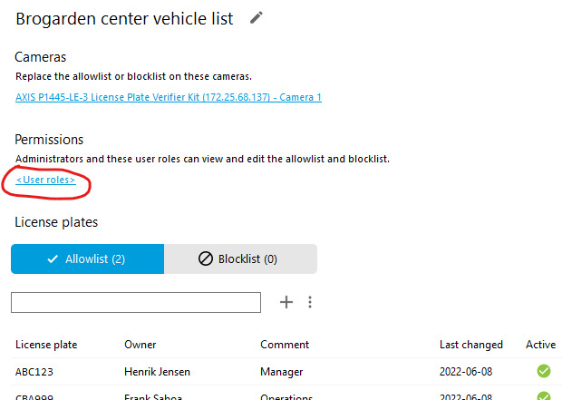

Here is an example of how we use the Role entity with a custom entity directly in our own UI (Management client plugin). This works fine on Corporate and Expert but on plus-versions we get an permission-excpetion when trying to check if a non-admin is member of a specific Role.
  • Is there a solution for checking the Role membership on plus-versions?

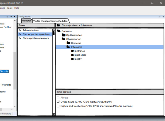

I also want to share another specific use-case we have. In this example we want to assign “Time profile” for a group of cameras and for a specific Role. The problem with security-actions is that it is only allow&deny - in this case we want to attach a time-profile instead. Is there a solution for this?
