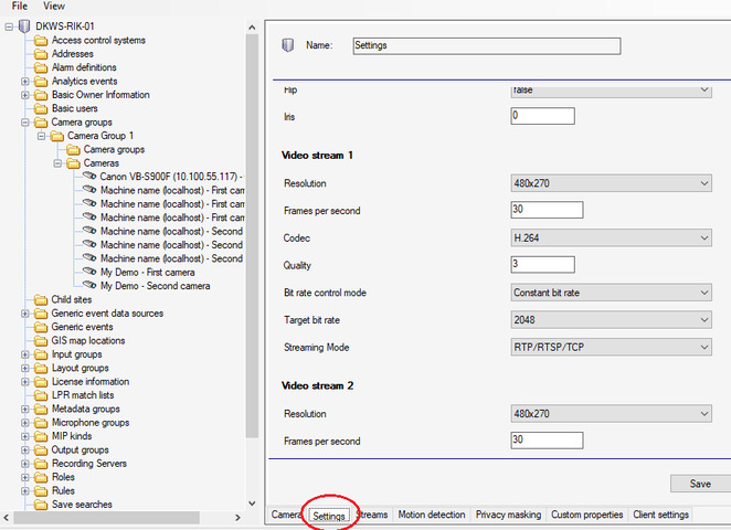

3. Config API Client can show this, please explore Config API Client.
