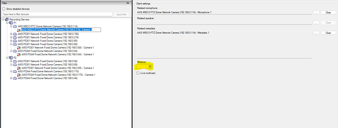

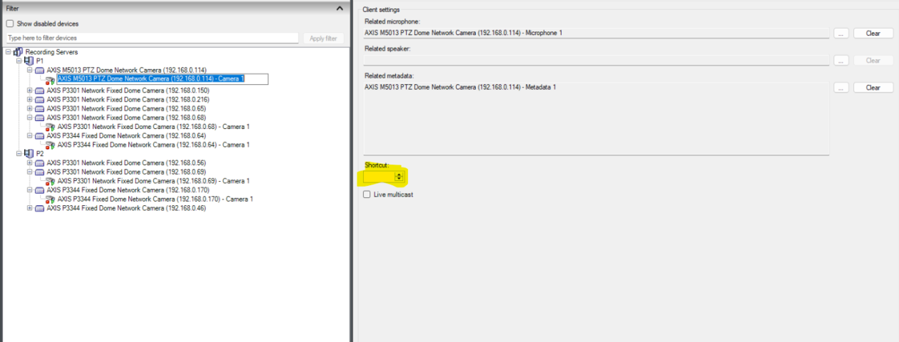

In Management client UI, we have not set any shortcut under clientsetting.

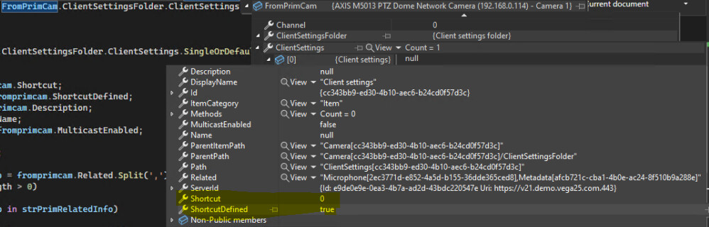

But when accessing from configAPI, we get shortcut = 0 and shortcutdefined = true.
If we set back and save , we get shortcut in the camera group during selection in SC.
Is this a bug that causes us to get a shortcut when it is not set in the management client UI?

We read the client settings from the primary camera, set them to the secondary, and save. Note that in primary the shortcut is “” (empty string)

In current MIP SDK version the Configuration API returns on Shortcut a default value “0” instead of null or undefined, there is no way the value returned can be “”.
If the older VMS interpreted Shortcut “” as a valid value that should mean that ShortcutDefined should be ignored, then the observations makes sense..
An easy workaround would be that if Shortcut is “” or 0 then ShortcutDefined should be set to false and Shortcut to 0.
