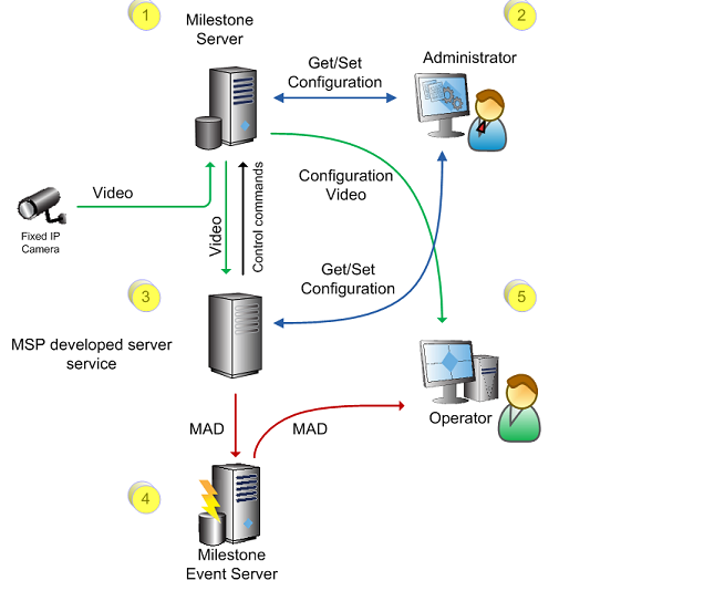

Hi Michael,
you mean, I have Events Server on the one computer, recording server on other computer. there is one Event Server. I don’t know how to configure to link Event Server with Management Client. I attach image about my system. Milestone Server on 1 computer, Event Server on 4 computer. I think I must configure in Tool->registered service of management Client. Can you intruct detail for me?
Thank you so much.
