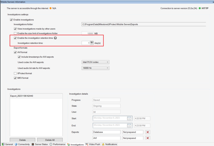

However, I currently have a test configuration of Enable retention time of 1 day, but data older than 1 day is not automatically deleted.
  • This is my config

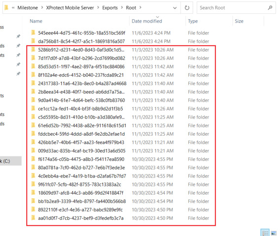

  • This is the Exports folder
Can I ask if I have configured it correctly? If there is any more, please let me know, thank you.

Yes, you have configured this correctly (assuming you have saved the configuration shown on your first screenshot).
Please do the following experiment:
  1. stop Mobile Server
  2. rename [C:\ProgramData\Milestone\XProtect](file:C:/ProgramData/Milestone/XProtect) Mobile Server\Exports\ to something else
  3. start Mobile Server
  4. create an investigation and make sure investigation is listed in Investigations tab
  5. wait 1 day
  6. make sure investigation is not listed in Investigations tab
  7. check [C:\ProgramData\Milestone\XProtect](file:C:/ProgramData/Milestone/XProtect) Mobile Server\Exports\Root folder
If issue persists, please upload here the Mobile Server log file.
