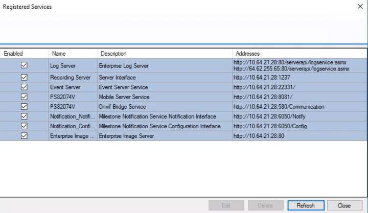

Last question however, is what does an example URI for a camera look like in the SystemInfo.xml? I see guid info but no tags for or related. Or could it be referring to the recording server in the registered services window as shown here? Because if that’s the case, it didn’t work.
In the SystemInfo.XML you find a “hostname”, this is the recording server a Milestone client should connect to in order to get the camera footage. (Note it is the recording server.)
Example from an XProtect Corporate to illustrate -
c7190df5-aeda-41b9-ac28-fb2a0dc209b3dkws-ba-03.milestone.dk7563
Apparently its hostname is set to 127.0.0.1 meaning it hasnt been port forwarded yet? Is there an option in the Milestone Management to do so? Essentially I am remotely connecting to it but not from the computer hosting the management application.

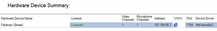

Strange, we’ve already setup our service with the “Internet” checkbox and I am able to login to our Milestone server and the Management App says it is connected to the Recording Server. Shouldn’t I be able to connect to the camera once it is hooked up to the Milestone server using the IP here?
Upon every camera I connect to, the LiveService sample try and catch ‘cerr<<“\n”<<error.GetSpecificError();’ always spits out “00000000000000” which I assume is a timeout since it waits a little bit.
No. What you show here is the IP used by the recording server to contact and communicate with the camera. A Milestone client does not contact or communicate with the camera, a Milestone client contacts the server and all communication is with the server. When routing for external access you can ignore the cameras themselves (if they are in the LAN with the server) and concentrate on opening the communication with the server.
Perhaps now you can see this with new eyes.. In the SystemInfo.XML you find a “hostname”, this is the recording server a Milestone client should connect to in order to get the camera footage.
I hope this makes sense (and I hope I have understood what you have been trying).
