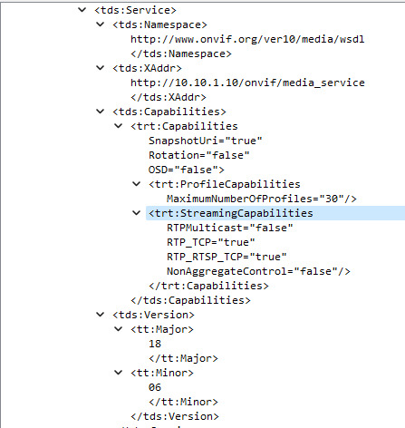

“NmONVIFDevice::SaveXPCOStreamSettings()@ONVIFSettings.cpp:403 Error: Protocol=‘Protocol_RTP_UDP’ does not exist, using ‘Protocol_RTP_RTSP_HTTP_TCP’ instead” which is why the GetStreamUri requests HTTP as the protocol but I’m trying to change it to RTSP as that is what I am using. I have it so in the GetServicesResponse it does RTP_TCP and RTP_RTSP_TCP so I’d like to know more about how it determines which protocol to use here. I’ve attached the logs as well. Thank you so much again for all the help :slight_smile:

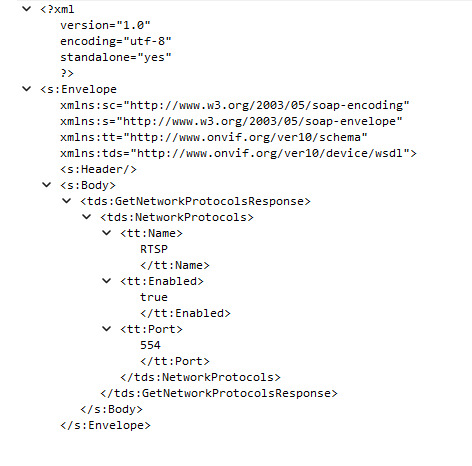

Forgot to mention, there is also GetNetworkProtocols returning support for RTSP. Here is also an attachment of the pcap
I think there could be some mismatch between the cached capabilities of the device and the actual capabilities. Can you try removing the device, restarting the Recording Server, and adding the device again.
Thanks a lot for the help Maxim. Digging around more with it you were right although restarting it didn’t delete the cache. I deleted my device under %ProgramData%\Milestone\XProtect Recording Server\DriverCache\NativeDrivers and the Devices.ini and am now getting a valid stream and also added PTZ. Thanks again for all the help and pointing me in the right direction :slight_smile:
